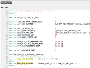

4- in secure_boot loder_ble_s140_pca10056 project the sdk_config.h  shows NRF_DFU_BLE_BUFFERS set to 8 pages. What is the minimum # of pages for a safe DFU? The comment writes if this value is made too small DFU will fail. is 6 pages considered small, or 4 or 2?

    4. This configuration options specifies how many BLE DFU packets that the bootloader can queue up in RAM. I would recommend to keep the default setting here (i.e. NRF_DFU_BLE_BUFFERS_OVERRIDE == 0).

  • Thanks Vidar for your answers. I had already seen those illustrations. For some reason, when I was looking at other posts, someone had mentioned that every time a dual-bank application update is performed, the Soft Device will also get updated!!! I didn't think this was the case and wanted to clarify.
    I realize SD updates will happen via dual-bank and that is fine. We won't be doing many of those hopefully.
    8 pages seems a lot of storage, but if cannot be reduced then will leave it alone.
    Are you reffering to the NRF_DFU_BLE_BUFFER that buffers the BLE dfu packets? This buffer is only 4096 bytes and is kept in RAM and therefore freed when the bootloader starts the main app.
