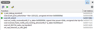

uart:~$ E: Fatal error occurred
ASSERTION FAIL @ WEST_TOPDIR/nrfxlib/nrf_802154/driver/src/nrf_802154_notification_swi.c:154
Call stack is this:

    We have two theories:
    From the problem description it sounds very likely to be a problem caused by packet collissions due to high traffic, but there should be ways to handle this according to our Zigbee team.
    It could also be an issue with lack of RX buffers. You may try to increase the number of buffer via Kconfig first and see if that helps:
    # Increase the number of RX buffers
    CONFIG_NRF_802154_RX_BUFFERS=32
    Try this and let me know how it goes. I will update you when I have more information as we continue to investigate this internally.
    Marjeris
  • Hello Marjeris,
    By increasing the buffers to 64, it did become a lot more stable so that was a good suggestion.  We are getting boss zdo asserts when we ask all devices to leave, though. If we cannot find a work around I'll post another ticket with details.
