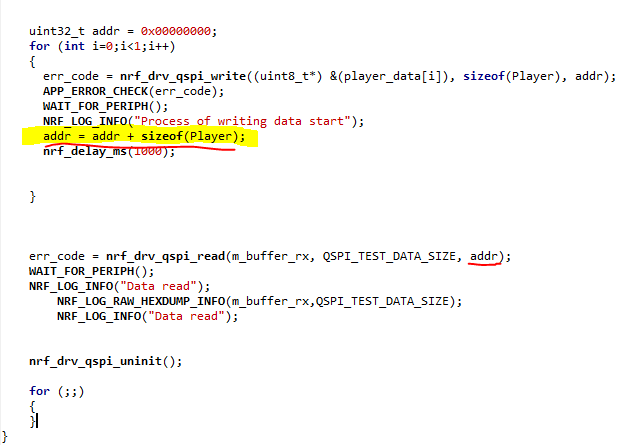

I am currently having issues with storing structure data in nRF52840 DK external flash. The default QSPI example present in peripheral sections work fine. But in my use case i have to store structured data instead of simple data types. I have worked with storing structured data in flash with STM boards so i know how to store data in flash.
But for some reason whenever i try to write structure data using QSPI example it always read out 0XFF which means the write operation didn't worked. But the write operation returns Success as return value.
For Example:

Here is my main.c file for QSPI example trying to achieve the above but without any success.

    uint32_t addr = 0x00000000;
    for (int i=0;i<1;i++)
      err_code = nrf_drv_qspi_write((uint8_t*) &(player_data[i]), sizeof(Player), addr);
      WAIT_FOR_PERIPH();
      NRF_LOG_INFO("Process of writing data start");
      addr = addr + sizeof(Player);
      nrf_delay_ms(1000);
    err_code = nrf_drv_qspi_read(m_buffer_rx, QSPI_TEST_DATA_SIZE, addr);
    WAIT_FOR_PERIPH();
    NRF_LOG_INFO("Data read");
        NRF_LOG_RAW_HEXDUMP_INFO(m_buffer_rx,QSPI_TEST_DATA_SIZE);
    nrf_drv_qspi_uninit();
    for (;;)
Can anyone please help me and tell how could i store and read structured data using QSPI example in NRF5 SDK ?
