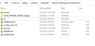

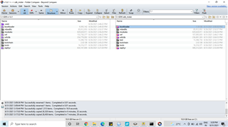

Hi I am working on nrf5340 direction finding example using nrfconnect zephyr v1.6.0-rc2. i had build example zephyr\samples\bluetooth\direction_finding_connectionless_tx for build_nrf5340dk_nrf5340_cpuapp. when i am debugging it facing issue
static int bt_rpmsg_open(void)
BT_DBG("");
while (!bt_rpmsg_platform_endpoint_is_bound()) {
k_sleep(K_MSEC(1));
return 0;
code is stuck in this loop.
i search issue i found that i have to program hci_rpmsg project in network core. i  build this for  build_nrf5340dk_nrf5340_cpunet and tried to flash but i am not able to flash it getting error-
