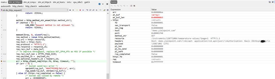

I tried to get the SLM application in debug mode and I could see its getting the proper string for httpc.headers variable in handle_AT_HTTPC_REQUEST function of the slm_at_httpc.c source file.
