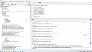

I am trying to implement FOTA in my application. I can implement non secure bootloader and run successful
in prj.conf
# Added for FOTA
CONFIG_BOOTLOADER_MCUBOOT=y
CONFIG_MCUMGR=y
CONFIG_MCUMGR_CMD_OS_MGMT=y
CONFIG_MCUMGR_CMD_IMG_MGMT=y
CONFIG_MCUMGR_SMP_BT=y
CONFIG_IMG_ERASE_PROGRESSIVELY=y
CONFIG_MCUMGR_SMP_BT_AUTHEN=n

And Now I am need to add secure bootloader
generate priv.pem and placed in
and added these line extra in prj.conf
CONFIG_SECURE_BOOT=y
CONFIG_SB_SIGNING_KEY_FILE="priv.pem"
but project getting failed
how to add secure bootloader to our project
and also
How to use Single slot bank instead of using Dual banking
  • Hi Sunil,
    See this tutorial. You need the following configuration:
    CONFIG_BUILD_S1_VARIANT=y
    CONFIG_FW_INFO=y
    CONFIG_FW_INFO_FIRMWARE_VERSION=1
    You could do serial dfu within the bootloader itself. Otherwise, it has to be "dual banked"
