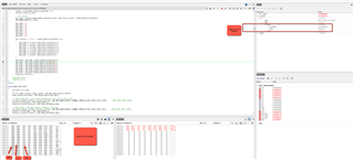

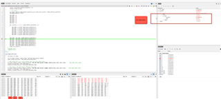

I am working on a project where I am using 8 ADC channels on the nRF52832.  When I run the code the device seems to get ADC values that look correct.  But, if I pause the device or hit a break point the ADC values seem to be off.  At first when I run the code, the ADC values seem to be in correct memory region, address.  When I pause the code and restart it, it seems as if the ADC readings have move over by two bytes.  Please see the attached images.  I tested this by modifying the analog signal that would be seen on AIN2, and I can see that from the first picture, the values of AIN2 appears to be in the column 3 and changing.  After pausing and restarting the device, the readings for AIN2 appear to be in column 4.
What is going on here?  Can anyone offer any suggestions?
I am using a nRF52832 in a module from Raytac.

  • Good day,
    So when the saadc_callback occurs, I was not stopping the timer.  I have added a disable of the timer at the start of the saadc_callback and then re-enable it when completing the callback.  This seems to have fixed the issue.
    The callback now looks like this.

  • Hi
    That was a different solution than I expected, but good to hear you found the issue Slight smile
    Best regards
    Torbjørn
