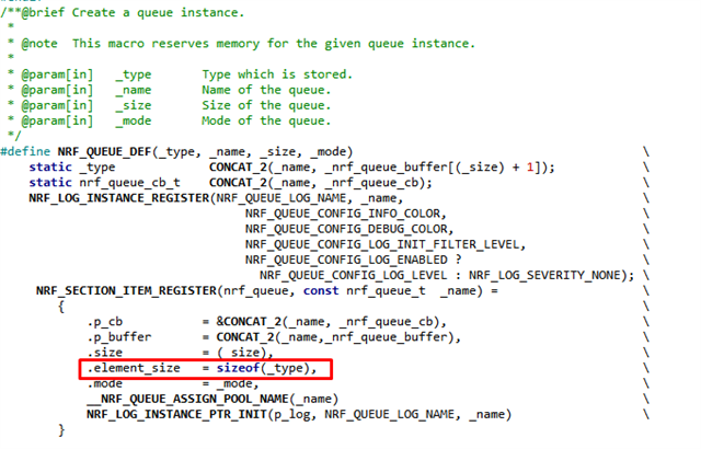

  • Hi ovrebek,
    I tried to follow your implementation but it doesn't work
    typedef struct
        int16_t records[16];
    } my_sensor_data_t;
    NRF_QUEUE_DEF(sizeof(my_sensor_data_t), m_sensor_data_queue, 200, NRF_QUEUE_MODE_OVERFLOW);
    I get the following error
    May should I do something like this?
    typedef struct
    } my_sensor_data_t;
    NRF_QUEUE_DEF(my_sensor_data_t, m_sensor_data_queue, 200, NRF_QUEUE_MODE_OVERFLOW);
    Because the in the definition of NRF_QUEUE_DEF() you calculate the size of data type
    Any advice?
  • Hi Nick
    You are totally correct, using the sizeof operator was a mistake on my part.
    The code without sizeof should work fine.
    Sorry for the confusion ;)
    Best regards
    Torbjørn
