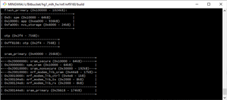

  • Hi Vidar,
    Per your question, looking at the MAP files and memory of the device, here is what I have:
    1. Image header @ 0x10000 (512 bytes total: 32 header bytes + padding bytes)
    2. SPM code @ 0x10200
    3. Application 'code @ 0x20200
    Thoughts?
    Regards
    Peter
  • Hi Vidar,
    As a test I disabled mcuboot, and the resulting layout is below.
    Everything got shifted to lower memory addresses due not having the mcuboot, but the application is still located in the secure partition starting at 0x10000 even though (as mentioned in an earlier post) it is specified to go to the non secure partition.
    I am able to read the flash at 0x10000 without getting the fault, but now I don't have the mcuboot to handle the firmware updates.
    So my question is, what is the dependency between having the mcuboot enabled and reading out of flash from the secure area? In both cases the SPM is enabled.
    Regards
    Peter
