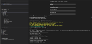

  • Hi Peter,
    Yes I was wondering if you built the app as non-secure. I think you may be attempting to read from the mcu pad area for the SPM which runs in the Trust Zone secure domain.
    Here is a screenshot I took from VS code with the new nRF connect plug-in to illustrate what the typical memory layout may look like:
    Notice that the main non-secure application starts after the SPM at 0x50000.
    Vidar

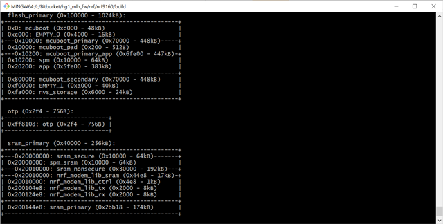

  • Hi Vidar,
    See the layout in my project below, which looks similar to the one you sent:
    Regarding the secure and non-secure partitions, in the DTS they are currently as follows:
    partitions {
    						#address-cells = < 0x1 >;
    						#size-cells = < 0x1 >;
    						boot_partition: partition@0 {
    							label = "mcuboot";
    							reg = < 0x0 0x10000 >;
    						slot0_partition: partition@10000 {
    							label = "image-0";
    							reg = < 0x10000 0x40000 >;
    						slot0_ns_partition: partition@50000 {
    							label = "image-0-nonsecure";
    							reg = < 0x50000 0x30000 >;
    						slot1_partition: partition@80000 {
    							label = "image-1";
    							reg = < 0x80000 0x40000 >;
    						slot1_ns_partition: partition@c0000 {
    							label = "image-1-nonsecure";
    							reg = < 0xc0000 0x30000 >;
    						scratch_partition: partition@f0000 {
    							label = "image-scratch";
    							reg = < 0xf0000 0xa000 >;
    						storage_partition: partition@fa000 {
    							label = "storage";
    							reg = < 0xfa000 0x6000 >;
    From looking into memory, I don't have anything in the non secure partition at 0x50000, but I do in the secure one at 0x10000. Not sure why this is happening because the board file I use specifies the code to be in the non-secure partition:
    zephyr,code-partition = &slot0_ns_partition;
    Thoughts?
