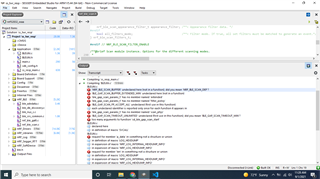

    Regarding the other thread, the application engineer assigned to the case is OoO this week which has caused some delay. I have bumped it and expect you will get a response tomorrow.
    Thanks a lot for your answer. However, I had some additional problems when I copied your code and imported the necessary files. The errors I'm getting seems to be in code level inside the nrf_SDK.
    I'm using nrf SDK 14.2.0 as that's the default for DWM1001 examples from github.com/.../dwm1001-examples. I tried upgrading it to 17.0.2, but I couldn't get it working with the examples. Though these code-level errors mostly stem from undefined variables. I don't think there's a bug in the SDK, but is there more files I should import? What should I do?
    There is significant API differences between SDK 17 and SDK 14. You can refer to this code for SDK 14.2. It drops right into the Nordic UART Service Client example projects in the SDK:

    Note that I just put this together very fast, so it is not perfect in any way. In my test it only ran for a second or two due to too much logging in an environment with many advertising packets. But you can take this as a simple reference and adapt to your needs.
