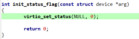

----> my guess : triggered by virtio (?)

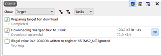

There is one "error" shown in SES while programming the network core:
Illegal value 0x210089D8 written to register 66 (MSP_NS) ignored

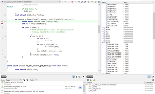

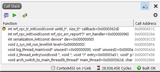

    Digging a little bit more in debugging mode (network core rpc_host, app core running empty_app_core via menuconfig).
    The fault seems to occur while executing "z_sys_init_run_level(_SYS_INIT_LEVEL_PRE_KERNEL_1);" line l.436 from init.c.
    The execution goes 2 times without success in for loop l.82 of device.c then at the 3rd attemp the CPU lock itself into fault_S.s.
    The flag SHCSR->BUSFAULTACT get to 1 which mean "BusFault exception active bit" (BUSFAULTENA been enabled).
    nRF DCNF doc extract : An attempt to access the blocked resources will trigger a BusFault or a HardFault exception, depending on the value of the BUSFAULTENA bit in the ARM Cortex-M33 SHCSR (system handler control and state register), described in the ARM Cortex-M33 Devices Generic User Guide.
    Link to The domain configuration (DCNF)
    Any idea of why and how to fix ?
