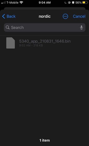

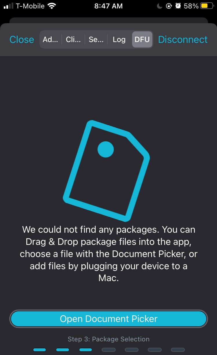

Hello everyone,
I'm unable to perform DFU over SMP BT with nRF Connect for iOS. I've already verified the process works with mcumgr (Ubuntu 20.04 LTS) and with nRF Connect for Android.
The issue is the inability to select any particular binary from Google Drive when I'm at the Document Picker (they're all greyed out and unselectable). See pictures below for reference:
I'd appreciate any pointers!
Luis.
    Which version of nRF Connect for iOS are you using and which phone are you testing with?
    You need to wait for the next version of nRF Connect, our developer is fixing this for the next version. If you can't wait it is also possible to beta test the next version if you like, just send me a PM with your name and email.
