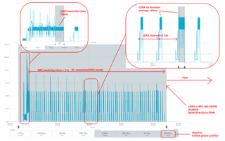

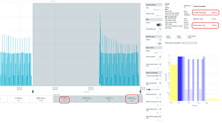

Need to figure out network parameter?
   I am using nRF9160DK(PCA10090, 1.0.0)
   I am using UDP sample to check power consumption and estimation.
   PPK2 is used for this test. It looks OK.
   I also like to use online power profile  for the convenience. But, It is hard to match on my side because of lack of network knowledge.
   Can you help me out to figure out about network parameter in my test environment to use in online power profile?
   I attached PPK log I got from PPK2( UDP sample, PSM mode, 40bytes packet length, 60 seconds interval)
   For the information, I am located in Montreal, Canada. TELUS is used as network operator.
   Thanks in advance.
ppk_UDP_40Bytes_60sec.log
