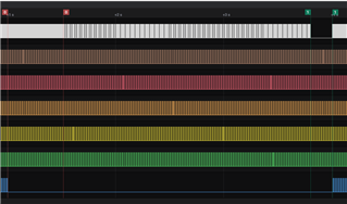

For my project I am using up to 6 connected peripherals to my central and I was watching the behavior of the link when one of the 6 devices disconnected and reconnected and I stumbled upon something I cannot explain.
I am using sdk 7.0.2 and I am using the sd_ble_gap_conn_evt_trigger_start function to trigger a EGU3 task per connection handle. In this task I set and clear a GPIO pin to visualize this on my logic analyzer.
Connection event is every 15ms and the GAP length is set to 2.
A color legend from my image:
White is the central triggering every time a peripheral is asserted.
Brown to blue are connected peripherals.
I disconnect one peripheral and after my set time of 500ms timeout I can see that the central has detected that the peripheral is missing. (red markers)
After x amount of time the central stops completely with generating connection events for a random amount of time. In my case here its 200ms (blue markers) before it starts again and this time with all 6 devices.
Can someone guestimate or explain what causes this drop in connection events?

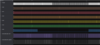

    I am still not sure what this is. Can you specify exactly which events you are expecting? You will not get events from the SoftDevice for empty PDUs. So if nothing happens after the connection is established you will not get any other events after the BLE_GAP_EVT_CONNECTED event. I understand you do get some events that suddenly stop coming though, but without knowing which events we are talking about it is not easy to say more.

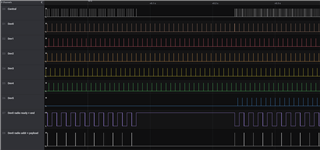

  • Here is a zoomed in section of the connection events from the cental when one peripheral disconnects. As you can see from this image one interval is skipped due to the missing link.
    When the central tries to re connect to the disconnected peripheral I see this.
    What I expected to happen is that the connection events generated by the other devices would continue instead of halting completely.

    I have tested to see if a link with another peripheral actually stops for that brief moment and it does.
    OK, now I see. This could be scanning. I assume the central starts to scan again after the disconnect? And if none of the links are close to timeout, scanning will be done even if that means dropping connection events.  See SoftDevice timing-activities and priorities.
  • I shall dive into this and try to mess around with the scan settings, I'll get back in a bit.
    Edit:
    Thanks this was indeed the case, I had my scan interval and window set both to a size of 2,5ms.
    I have increased the interval to 10 times what I had and the scan window to 3 times what I had and it fixed the problem.
