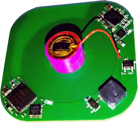

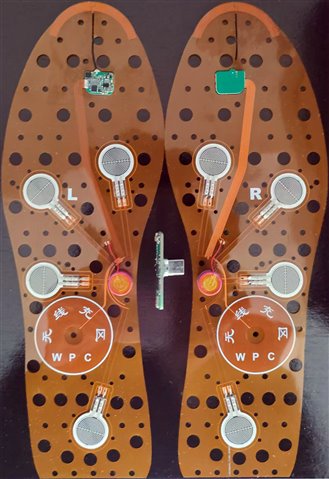

  • I develop two products that can be used for the purpose,
    Insoles. By integrating FSR(Force Sensing Resistor) and IMU, the insoles can detect plantar pressure and foot posture. I choose nrf chip to send data to cellphone or PC, so it can be used for gait analysis. The insoles integrate wireless power charging and antenna either, which looks similar to an ordinary insole from the appearance.
    This solution can also be applied to shoes. If interested, you can refer to: https://zhuanlan.zhihu.com/p/2020121495549002419.

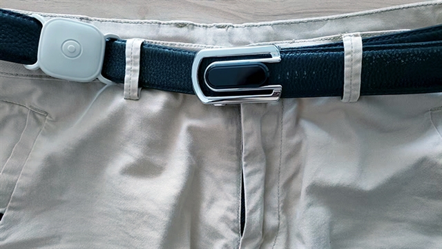

    Tag. It can be mounted on the belt to detect body posture. IMU is integrated acommpany with nrf chip, wireless power charging and antenna are implemented either.
