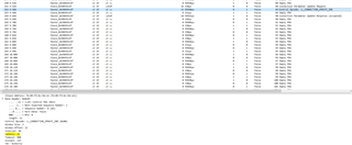

We used the nRF Sniffer to capture the disconnect:
htc10-disconnect.pcapng
This error only happens sporadically, we do not see a pattern. On some phones  - as the one with device information below that was used for the sniffer trace - it happens more frequently.

    Please let me know what LF clock configuration you use as well (i.e. NRF_SDH_CLOCK_LF_SRC, NRF_SDH_CLOCK_LF_RC_CTIV, NRF_SDH_CLOCK_LF_RC_TEMP_CTIV, and NRF_SDH_CLOCK_LF_ACCURACY in sdk_config.h).. The sniffer trace is showing a high number of re-transmits (mostly the slave not receiving the packets from the master) and I'm wondering if it might be due to clock drift.
    Also, I see you define TX_POWER as -16, does that mean the TX output power is only set to -16 dBm during connections? If so, do you see any improvement if you increase it?
    Vidar

    Increasing the TX Power to 0dBm does also result in the high number of re-transmits.
    As a test, can you please try to select the NRF_CLOCK_LF_SRC_SYNTH source and repeat the test? This is to rule out any issues with the 32KHz crystal.
    Vidar
  • Thanks. Have you been able to replicate the sporadic disconnects after changing the clock source? I may have overlooked this earlier, but the re-transmits I see now are to be expected because you have slate latency enabled (slave latency allows the slave to skip x connection events when it doesn't have data to send).
