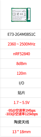

Hello, I have realized communication, but the pairing distance between them must be within 0.3m. Otherwise, the pairing cannot be successful. After the pairing is successful, the communication distance over 1m will fail to be sent
I have adjusted #define GZP_POWER NRF_GZLL_TX_POWER_4_DBM

I use NRF52840. The module of NRF52840 I bought is in China.
Hi
Have you mounted the module on a PCB?
If yes, can you send me a picture of it?
Usually these modules need to be mounted on a PCB with sufficient grounding in order to achieve optimal performance, and the module manufacturer should provide instructions how to design the PCB.
Have you tested with a standard nRF52840DK to see how the range compares?
If you can test with a DK it will show whether or not the issue is related to the hardware you are using.
Best regards
Torbjørn
