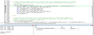

I looked at your project and did not see any issues with regard to this. Also, when I test it works as expected.
See here from first run after programming, where the pins are NFC as expected:

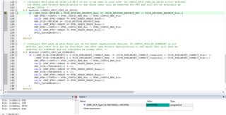

then I let execution continue and the UICR is updated and reset occurs, and the same breakpoint is hit again:
So far it is as expected. Also, when I check with nrfjprog I get:
