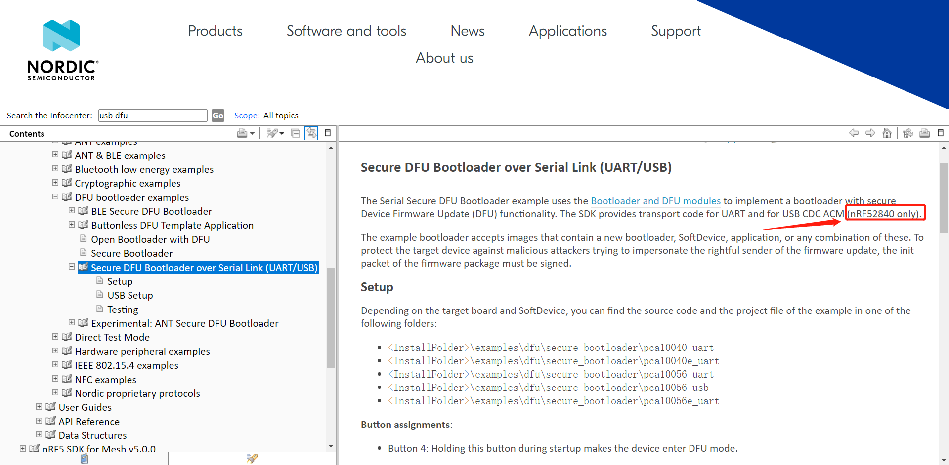

                   1、 I can't find the USB DFU example of the nrf52820 in the SDK.Does nrf52820 support USB DFU?

    The statement you refer to is old, from when the nRF52840 was the only nRF52 series device with USB, but has unfortunately not been updated. There is nothing preventing you from using USB DFU on the nRF52820. There is also example projects for this in the SDK, under <SDK17.0.2>\examples\dfu\secure_bootloader\pca10100e_usb*. Note that these projects are using nRF52820 emulation on the nRF52833 DK.
