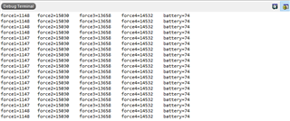

wrong values after connecting over BLE
I want to transfer analog values via BLE to a external Device. The SAADC is initialize for 2 channels, triggered by RTC-timer and i've get the right values from both channels. When i connect over BLE, the values i get change from ~12000 inc to ~9000 inc (14 bit resolution). Also after disconnecting the values are wrong until i restart the nrf.
My suppostion is a wrong Ramtable in Segger Studio, i have to change NRF_SDH_BLE_GATTS_ATTR_TAB_SIZE, NRF_SDH_BLE_VS_UUID_COUNT
// <o> NRF_SDH_BLE_GATTS_ATTR_TAB_SIZE - Attribute Table size in bytes. The size must be a multiple of 4.
#ifndef NRF_SDH_BLE_GATTS_ATTR_TAB_SIZE
#define NRF_SDH_BLE_GATTS_ATTR_TAB_SIZE 1900
// <o> NRF_SDH_BLE_VS_UUID_COUNT - The number of vendor-specific UUIDs.
#ifndef NRF_SDH_BLE_VS_UUID_COUNT
#define NRF_SDH_BLE_VS_UUID_COUNT 20
in sdk_config.h and RAM_START=0x200026b8, RAM_SIZE=0xd948, because i have over 15 characteristics.
But when i read the softdevice spec, it must to be enough reserved ram.
SDK 15.3.0
Softdevice 6.1.1

    i have check this on the nRF (see code line 215). Channel 1 is for battery voltage and at the second channel i use a MUX to get 4 values of force. I have checked my code without MUX and lower sample rate with the same result.

    here my debug window after restart

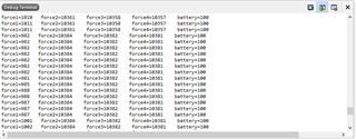

    and here after connection over BLE
  • Do you observe the same if you try to measure something external from the PCB such as a voltage from a bench top supply? Also, do you do any sorts of calibration after a connection event?
  • Sorry for the late answer, i have to do another project first. I have checked my hardware and the voltage at the analog inputs are correct. But i found out, that the buffer values are swap when i reconnect or write to a BLE characteristic. Is there any way to prevent that?
    It sounds very similar to this issue. Please try the suggested solution in that thread.
    best regards
    Jared
