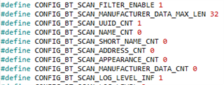

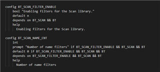

This is the main Kconfig part:
The scanning is maked only on coded. I don't know why but on autoconfig.h generated by the compiler...
The filter by name can't be setted.
I am so really stuck, any ideas are welcome
Thanks, regards.
  • If i use the default scann with UUID i haven't any problem for scan, but my devices never connect. I will change the filter because i read on documentation that on coded phy isn't possible use this UUID filter.
  • It's so strange, when i change autoconfig.h manually to set:
    #define CONFIG_BT_SCAN_UUID_CNT 0
    #define CONFIG_BT_SCAN_NAME_CNT 1
    #define CONFIG_BT_SCAN_SHORT_NAME_CNT 0
     When I build the project, there aren't errors and my scan starts. But autoconfig.h is modified automatically by the compiler i think, and Segger studio ask me if i want to reload the project, if i accept autoconfig.h seems like:
    #define CONFIG_BT_SCAN_UUID_CNT 1
    #define CONFIG_BT_SCAN_NAME_CNT 0
    And if i build that project with that autoconfig.h i get the error described previously. I do't know why is my autoconfig modified automatically when i build, and why is modified always with the same parameters, independenly of my code.
