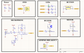

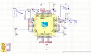

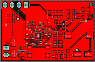

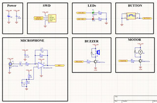

I have been using the nRF52840 DK board and have designed a PCB based on it. I made a previous post asking some questions before designing the PCB, so this is a follow-up.
https://devzone.nordicsemi.com/f/nordic-q-a/78124/going-from-nrf52840-dk-to-pcb
With the schematic, I haven't changed anything except adding my connections to the pins, and using Generic No ERC markers on the unused pins. The PCB I kept the same and add my components above it, and the battery on the bottom layer. The only changes I made were extending the top layer ground polygon (red), and using the vias around the nRF chip to branch out a ground and VCC line.
1) Is my PCB fine to manufacture or are there any changes I should make to it. My design uses a few GPIO pins, analog pins, and Bluetooth to communicate with. I used configuration 6, from the reference design.
2) On the schematic there is an optional section with a crystal connected to XL1/XL2. Do I need to have this on my design?

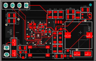

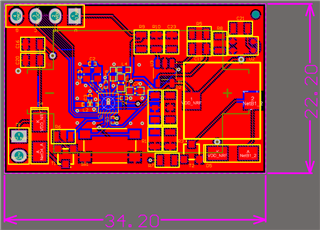

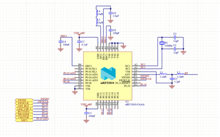

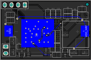

  • No worries. I actually changed the nRF chip I used in the initial post. I noticed that there is a cheaper and "simpler" one, that I can use, as I only need a few GPIO pins. I ended up using the nRF52810. I haven't used this chip before, so I hope my code will still work with minor changes. I added the screenshots of the new PCB below.
    I added the original post below but changed the questions:
    With the schematic, I haven't changed anything except adding my connections to the pins, and using Generic No ERC markers on the unused pins. The PCB I kept the same and add my components above it, and the battery on the bottom layer. The only changes I made were extending the top layer ground polygon (red), and using the vias around the nRF chip to branch out the ground and VCC lines.
    1) Out of the reference designs for the nRF52810, I picked the nrf52810_caaa_2-layer as opposed to the nrf52810_caaa and nrf52810_caaa_dcdc designs. I'm not sure what advantage the other two have over the one I picked, based on the simplicity of my design.
    2) Will this PCB work or are there any changes I should make?

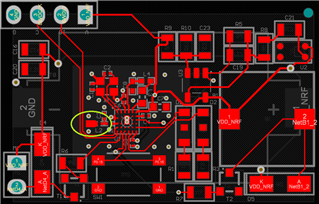

    I have taken a look at the design now and here are my initial comments:
    You need to extend the bottom layer polygon as well and connect the top and bottom ground using via stitching as well as adding vias right next to all component ground pads.
    I recommend using the nrf52810_qcaa_dcdc as the package type is easier to implement for simple designs like this. It's 5x5mm instead of 2.5x2.5mm, so if you can spare the space I'd make the change. You can read a bit about the reference circuitry in the product specification.
    You also need an antenna on the board, the thick trace marked with green is the beginning of the antenna transmission line:
    You need unbroken ground on the bottom layer under the antenna transmission line, i.e. no routing or components under it.
    You can look at the hardware files for for example the nRF52832 Development Kit on how to implement a simple quarterwave monopole PCB antenna. It includes a connector in the transmission line for ease of radio measurement, but you can remove that from the design.
