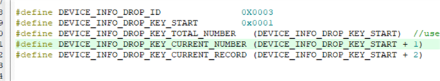

app time loop update 200 byte data use fds by 10s ,then after many time error happened, update_user_flash is update API, write_drop_record IS loop write API in app time,

 id and key
