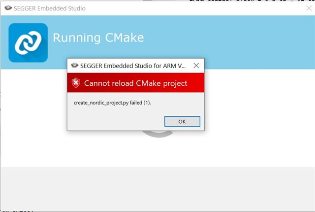

  • Hi Simon,
    If "CONFIG_APP_WIPE_STORAGE=y" is included in prj.conf I get an error when Cmake executes.
    I then checked: http://developer.nordicsemi.com/nRF_Connect_SDK/doc/latest/kconfig/index-all.html
    and didn't see it listed as a legal CONFIG option, so I assumed it had been removed.
    The call returns -5 (0xfffffffb)

  • I stepped back and used the littlefs sample project to just test the Flash/LittleFS interface of my new board.   Since the board is new, the flash has never been written, so when booting, the mount fails (as expected with an error at lfs.c line 997 (Corrupted dir pair at (0x0, 0x1))) and it appears LittleFS attempts to format the device.    It looks like it prepares a superblock, then attempts to write it.    A failure occurs during formatting (returning -28).    Looking this up in lfs.h shows that -28 indicates LFS_ERR_NOSPC (no space left on device).     Stepping through, it looks like the error is being thrown at line 1692 of lfs.c due to the comparison at line 1689.  I'm not sure why this is happening yet.    The device is new, so is there some other (erase?) procedure that needs to be performed before running this test?    I would think that formatting would prepare/initialize any information about the device needed for the file system?
    I removed the comment from the CONFIG_APP_WIPE_STORAGE=y line in prj.conf thinking that perhaps it might erase the device during the formatting process, but got the same error (-28).
    Note that CONFIG_APP_WIPE_STORAGE=y works here, but if I put it in my prj.conf running Cmake fails!   Both are using NCS 1.6.1  Running without the APP_WIPE config statement causes an error -5 (LFS_ERR_IO - Error during device operation).    As mentioned earlier, the device on the new board is very similar to the one on nRF52840DK, except larger.
