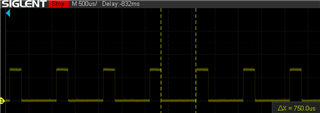

nRF52840 How to play 2 PWM sequences in one channel with different duty cycle in Common Mode?
I started to work in a recen project with previous code developed and I want to use the current code to play 2 PWM pulses but each pulse with different duty cycle.  For example, the 1st pulse at 100% 1000ms ON / 1000ms OFF and the 2nd pattern sequence at 25% duty cycle with the same 1000ms / 1000ms OFF.
Current code was able to play a pulse at one duty cycle and now I extended their usability to 2 pattern sequence, but as far as I try to modify the duty cycle independently, I ended with two pulses with the same duty cycle...
For this I wanted to implement the nrfx_pwm_complex_playback() function.
But after testing the behavior of the code, it seems that the dutycle is set by a line of code when I implement the 2nd sequence definition. specially in
// Write pattern to memory
p_mem2 = p_instance->p_mem;
nrfx_pwm_complex_playback(p_instance->p_drv_instance, &pwm_sequence, &pwm_sequence2, pattern_rep,
                                        NRFX_PWM_FLAG_STOP );

    // play two patterns here..
    nrfx_pwm_complex_playback(p_instance->p_drv_instance, &pwm_sequence, &pwm_sequence2, 2*pattern_rep,
if I removed that line of code, setup in sequence 1 is not ignored anymore. but both pulses will use the same duty cycle.
So my question is: How to set up two pulses with different duty cycle with the nrf_pwm_complex_playback() with pwm_sequence.values.p_raw ?  how to avoid this situation and do it properly?
    I can create small example that does this. What frequency should this 2nd pattern use?
     Here is some example code for that, based on pwm_driver example in nRF5SDK.
     * Copyright (c) 2015 - 2018, Nordic Semiconductor ASA
     * All rights reserved.
    /** @file
     * @defgroup pwm_example_main main.c
     * @ingroup pwm_example
     * @brief PWM Example Application main file.
     * This file contains the source code for a sample application using PWM.
    #include <stdio.h>
    #include <string.h>
    #include "nrf_drv_pwm.h"
    #include "app_error.h"
    #include "boards.h"
    #include "bsp.h"
    #include "app_timer.h"
    #include "nrf_drv_clock.h"
    #include "nrf_log.h"
    #include "nrf_log_ctrl.h"
    static nrf_drv_pwm_t m_pwm0 = NRF_DRV_PWM_INSTANCE(0);
    #define PWM_PIN 3
    #define TOP_VALUE 1000
    #define LOW 0x8000
    #define HIGH 0
    static void pwm_init(void)
        nrf_drv_pwm_config_t config =
            // These are the common configuration options we use for all PWM
            // instances.
            .irq_priority = APP_IRQ_PRIORITY_LOWEST,
            .count_mode   = NRF_PWM_MODE_UP,
            .step_mode    = NRF_PWM_STEP_AUTO,
        config.base_clock = NRF_PWM_CLK_1MHz;
        config.top_value  = TOP_VALUE;
        config.load_mode  = NRF_PWM_LOAD_COMMON;
        config.output_pins[0] = PWM_PIN;
        config.output_pins[1] = NRF_DRV_PWM_PIN_NOT_USED;
        config.output_pins[2] = NRF_DRV_PWM_PIN_NOT_USED;
        config.output_pins[3] = NRF_DRV_PWM_PIN_NOT_USED;
        APP_ERROR_CHECK(nrf_drv_pwm_init(&m_pwm0, &config, NULL));
    static void start_pwm_demo()
        // Sequence 0:   1000ms high level, 1000ms low level
        static nrf_pwm_values_common_t seq0_values[] =
           HIGH , LOW
        nrf_pwm_sequence_t const pwm0_seq0 =
            .values.p_common = seq0_values,
            .length          = NRF_PWM_VALUES_LENGTH(seq0_values),
            .repeats         = 1000,
            .end_delay       = 0
        // Sequence 1 : 25% duty cycle for 1000ms high, then low for 1000ms.
       static nrf_pwm_values_common_t seq1_values[] =
        TOP_VALUE-(TOP_VALUE/4) | HIGH, LOW
        nrf_pwm_sequence_t const pwm0_seq1 =
            .values.p_common = seq1_values,
            .length          = NRF_PWM_VALUES_LENGTH(seq1_values),
            .repeats         = 1000,
            .end_delay       = 1000-1
        (void)nrf_drv_pwm_complex_playback(&m_pwm0, &pwm0_seq0, &pwm0_seq1, 1,
                                           NRF_DRV_PWM_FLAG_LOOP);

    Output:

            NRF_LOG_FLUSH();
    Output:
