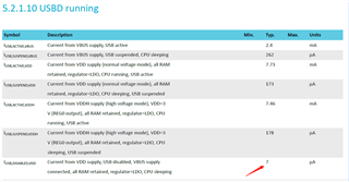

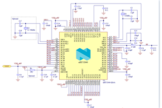

I am testing nrf52840 low power module on usb power supply, but it's current is about 22ua not 7ua.
hardware design
