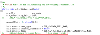

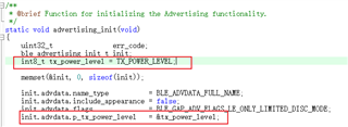

When I set the tx power in the broadcast initialization, I found that there are restrictions on the setting of the Bluetooth name, as follows
My device name:
Then I saw the bluetooth information in the phone as follows
But comment out the code to set the tx power, the name of the Bluetooth device can be fully displayed
Mobile phone display:
What is the reason?
    This is likely cause by the 31 advertising byte limit being exceeded when you add the TX data field.
    Including the TX data increases the payload size, which might cause it to exceed the hard 31 byte limit. The ble_advdata_encode function will then truncate the advertising name - by shaving characters off of the name - in order to make it fit into the 31 byte limit. Please see the warning of the ble_advdata_encode function's API reference for more information about this.

    So, back to your issue; I still believe that it is caused by the advertising data exceeding the 31 byte advertising payload limit.
    What is the total size of your advertising packet, with the above code?
    Please also keep in mind that every new datafield (i.e name, uuid's, appearance, manufacturer specific, etc) requires 2 bytes of overhead. So, if you have a 8 byte manufacturing specific data payload(2 bytes company identifier, and 6 bytes arbitrary data), it will take up 10 bytes of your total 31 available bytes.

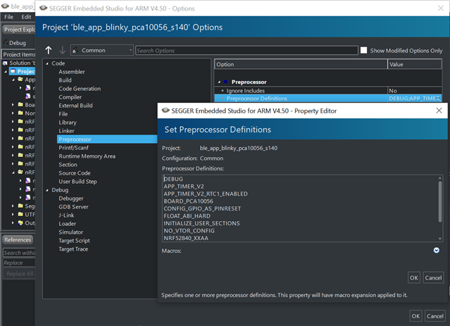

    Did you add the DEBUG define to your preprocessor defines like I asked?
    If so, are you getting any error messages in your logger when this behavior occurs?
    Karl
  • init.srdata.p_tx_power_level 	= &tx_power_level;
    Hello, I put the transmit power data in the broadcast return packet, so that the problem of the length of the Bluetooth name is solved. Thanks!
