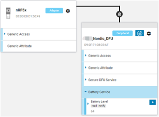

I have added the bettery service to ble_app_buttonless_dfu_pca10040_s132 project successfully.

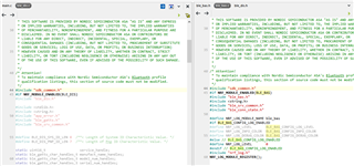

When I do the same set-up for the device info service, NRF_MODULE_ENABLED(BLE_DIS) remained false, so that the code is not complied.
Contents in sdk_config.h
The difference between ble_dis.c and ble_bas.c after rebuild project:
