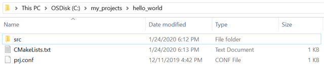

  • Hi Cederic,
    What are the difficulties you are seeing? Are you getting any build errors?
    Exactly which part would you like to be more clear?
    Have you created the three files, main.c(located in the folder src), CMakeLists.txt, and prj.conf and placed them in your project folder like this?
    If you want, you could upload the hello_world folder as a .zip. I could then take a look to see if anything is missing. I could also try to build it on my computer.
    Håkon
