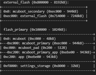

Now I am trying to merge the configurations to matter lock-example project on 52840DK.
I check the default partition layout listed in nrf52840dk_nrf52840 dts:
mcuboot       48K
image-0       412K
image-1       412K
image-scratch 120K
storage        32K
The matter stack can't fit in image-0 partition.
So what's your suggestion about the DFU over the air on 52840 for matter device?
