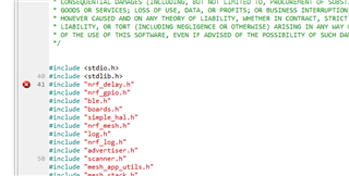

Yes, I use nRF52840DK. Actually, I try the method you mentioned on the link. But it doesn't work.
Errors tell me it cannot find the header files. I try to add the path as described in the document. It still cannot work.

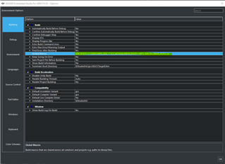

Try to set the SDK_ROOT macro manually in SEGGER Embedded Studio:
SDK_ROOT=<the path to nRF5 SDK instance>.
