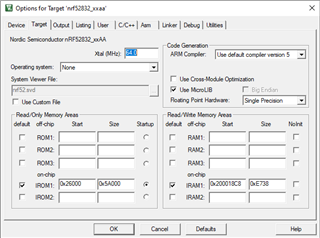

I am running ble_app_beacon demo from nRF5 SDK 17.0.2 on nRF52 DK and would like to decrease power consumption as much as possible. From this post, I have seen that it is possible for nRF51 but could not replicate for my case. Could you help me achieve this? Also I manually calculated the space given to application files in total by summing all application blocks visible in the nRF Connect Programmer app and yielded 0x755c. Besides that SoftDevice 132 covers 0x1596b in total and MBR sits on 0xaff.
Any help is much appreciated, thank you.

  • Burnie Barren said:
    I cannot give them the same address if I am using a SoftDevice, right?
     Correct.
    Burnie Barren said:
    In my case, minimum RAM is 0x20001628 and flash start is 0x26000.
     If you are using s132_nrf52_7.2.0, the minimum required memory is 5.6 kB (0x1668 bytes). So, the RAM start is 0x20001668. See release-note under nRF5_SDK_17.0.2\components\softdevice\s132\doc
    -Amanda
