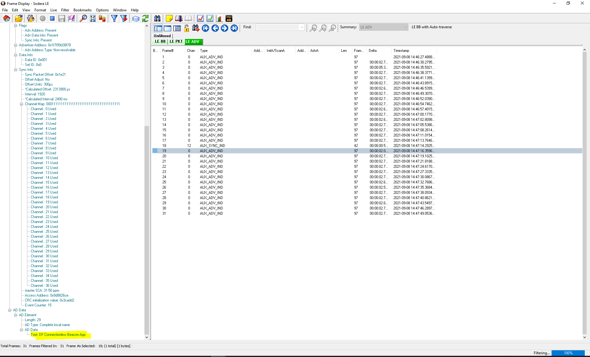

Samples direction_finding_connectionless_rx/tx (nRF Connect) not working (not finding the periodic advertising)
Hi, I'm trying to migrate to Nordic  nRF Connect APIs for Direction Finding. To start I just tried getting the samples direction_finding_connectionless_rx and direction_finding_connectionless_tx working, however I'm not able to get it working. The scanner never finds the periodic advertisement sent by direction_finding_connectionless_tx sample.
See logs:

Receiver:
west build -p -b nrf52833dk_nrf52833 -- -DTC_OVERLAY_FILE=boards/nrf52833dk_nrf52833.overlay
Starting Connectionless Locator Demo
Bluetooth initialization...success
Scan callbacks register...success.
Periodic Advertising callbacks register...success.
Start scanning...success
Waiting for periodic advertising...[DEVICE]: 52:2A:FB:2C:39:E4 (random), AD evt type 3, Tx Pwr: 127, RSSI -86 C:0 S:0 D:0 SR:0 E:0 Prim: LE 1M, Secn: No packets, Interval: 0x0000 (0 ms), SID: 255

Scanner never find the advertisments sent by the transmitter
Any idea why it's not working? I tried both nRF Connect 1.6 and 1.6.1 and tested sample both in nrf/samples and zephyr/samples/ folders.
