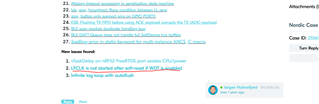

    Are you enabling the watchdog timer in your application, and in that case, is there a chance that you may have experienced a WD reset? If so, please check if you may be impacted by this bug mentioned here:
    https://devzone.nordicsemi.com/f/nordic-q-a/65422/what-are-sdk-17-x-0-known-issues
