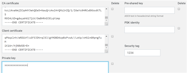

I'm using a nrf9160 DK running sample azure_iot_hub in nRF connect sdk v1.6.1
After generating the necessary certificates and loading them to the modem using Certificate manager in LTE Link Monitor v1.1.10, and setting the config according to the instructions in this guide: https://developer.nordicsemi.com/nRF_Connect_SDK/doc/latest/nrf/libraries/networking/azure_iot_hub.html#azure-iot-hub-flash-certs, I still get a 111 error (connection refused?).
This is the listing from LTE link monitor:

All he certificates are installed; as shown here:
2021-09-10T07:15:21.530Z DEBUG modem >> AT%CMNG=1
2021-09-10T07:15:21.549Z DEBUG modem << %CMNG: 0,6,"0606060606060606060606060606060606060606060606060606060606060606"
2021-09-10T07:15:21.552Z DEBUG modem << %CMNG: 10,0,"0000000000000000000000000000000000000000000000000000000000000000"
2021-09-10T07:15:21.565Z DEBUG modem << %CMNG: 10,1,"0101010101010101010101010101010101010101010101010101010101010101"
2021-09-10T07:15:21.572Z DEBUG modem << %CMNG: 10,2,"0202020202020202020202020202020202020202020202020202020202020202"
2021-09-10T07:15:21.582Z DEBUG modem << %CMNG: 4294967293,10,"0A0A0A0A0A0A0A0A0A0A0A0A0A0A0A0A0A0A0A0A0A0A0A0A0A0A0A0A0A0A0A0A"
2021-09-10T07:15:21.589Z DEBUG modem << %CMNG: 4294967292,11,"0B0B0B0B0B0B0B0B0B0B0B0B0B0B0B0B0B0B0B0B0B0B0B0B0B0B0B0B0B0B0B0B"
2021-09-10T07:15:21.595Z DEBUG modem << OK
any suggestion to how to fix this connection problem?
