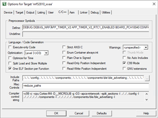

I am not sure, that depends on the root cause of this issue. Which SDK version are you using?
