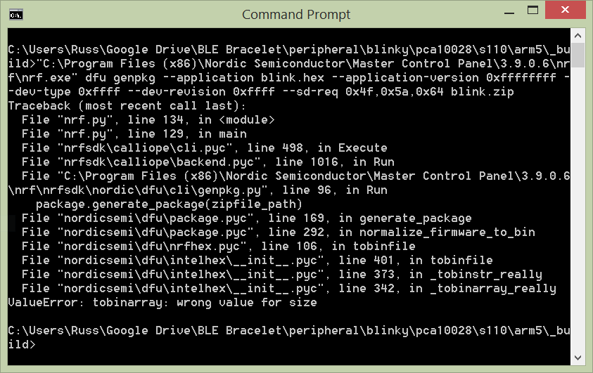

I'm just trying to build one of the example apps for the beacon kit and I'm running up against this cryptic error when trying to use dfu genpkg to build an application only firmware zip. Using Master Control Panel v3.9.0.6
Any ideas?

The hex file contains data in the softdevice region. Check out this thread to see what the start address of the application should be for the different softdevice versions. You can set this in 'Options for target -> Target' in Keil.
