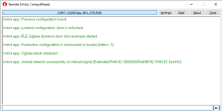

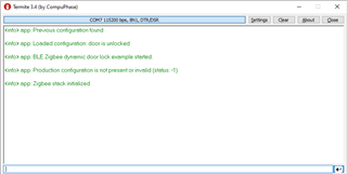

When I added these lines (SysTick_Config and NVIC_EnableIRQ) the example stops working as normal after zigbee stack initilized (uart log) and gets stuck.
My questions are:
1. Why cant I use the SysTick?
2. What else is a good option to use instead? app timer?
  • So I tried the app timer, but I get the same result. I enabled timer 4 in de SDK config and made changes from the example \examples\peripheral\timer to make use of timer 4.

    When I debug, the timer fires every time, but the zigbee log info shows me the same problem (started stack, but nothing else).
    When I remove the app timer (nrf_drv_timer_enable) zigbee joins again

    When I comment the line:
    nrf_drv_timer_enable(&TIMER_LED);
    it joins. When I dont, it wont...
