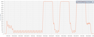

Hi  Team,
I am expecting 5.8 mA during advertising as per the PS of nrf52810, but I am observing around 8 mA. SDK used - 17.0.2
Device is consuming 2 mA when CPU is running, which is as per the datasheet.
Could you please let me know why is it consuming extra 2mA during advertising ?
