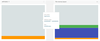

Then i merge my firmware to the softdevice (s132) like this (seen on the NrfConnect v3.7.1 - Programmer) :

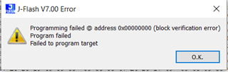

When i try to flash the code (F5 key) i get this error :
Where can this come from ?
I made sure the flash was empty before flashing.
I ran a different test when i only try to flash the app and it works, but when i try to flash only the softdevice i get the same error.

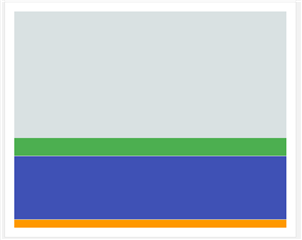

even after the error a part of the flash have still been written :
