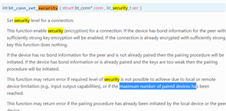

Failed to set security (-12) whn the connection is happening on UART example
Hi everybody,
I am with two custom oards that include nrf52840 chip, one acting as central and one as peripheal.
This example is custom to get multilink, for that i save the handlers of connections on array to make the managments.
I succes connecting my central to an nrf53 without problems, but when i try to connect to the nrf52840 (only one at the same time currently) i get this error when the connected function is triggered
Produced by:
Somebody can help me o discover why and how to close it?
Thank everybody,
regards.
  • I update with new information, for check and try to debug i get the original UART example central and peripheral and put it on the devices. The same error is triggered too. When this error is triggered theorically the conection is maded, but there aren't communication between devices. I suppose that is a Kconfig modification that i make and i am not be able to identify. There are some way to set a fixed security param statically on defconfig to avoid this problem on future??

    I will concrete the situation: I was working normally with a custom board as central and nrf53 as peripheral and i can connect without problems, in the past i could connect two custom_board too. But arrived to a  point that i unknown I only succes on connect with one nrf53. In the rest of cases(another nrf53 and the other custom_board) the error of secrity is triggered.
    The curiosity thing is that both nrf53 i upload the same code and the same child image and only in one i succes on the connexion. Another curiosity is that uploading the same code on both devices, on the programmer seems this:
    Device that i am able to connect
    Device that i am not able to connect
    Thn you for the fast response,
    regards.
  • Hi another time, the issue is closed, i get the error due to CONFIG_BT_SCAN_NAME_CNT=1 when i have a multilink system, setting it to CONFIG_BT_SCAN_NAME_CNT=19 is solved and the error never appears
