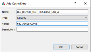

Hi, I am trying to compile and run the ble-pc-driver tests but am struggling.
My best guess based on the documentation is that I am specifying something wrong when configuring the cmake project (im using cmake gui).
based on the
pc-ble-driver/test at master · NordicSemiconductor/pc-ble-driver (github.com)
For example, if you have two PCA10056 boards, you provide the following defines the CMake when generating the project files: -DBLE_DRIVER_TEST_PCA10056_A=<SEGGER_SERIAL_NUMBER>:<SERIAL_PORT> -DBLE_DRIVER_TEST_PCA10056_B=<SEGGER_SERIAL_NUMBER>:<SERIAL_PORT> -DTEST_SOFTDEVICE_API=1
The test targets needs to be ran manually, the naming of the test targets are "test_run_sdv<SoftDevice_API_version>_<SoftDevice_type>_pca". Each of the targets first program the devices with the correct connectivity firmware and then starts the test. The test result is written in junit format in directory test-reports below the the test build directory.
I added specified these:
> nrfjprog --com
682179628 COM3 VCOM0
682935919 COM6 VCOM0
which seem to generate these files when built, based on the above text these aren't all the tests that should be generated
even so running test_sd_api_v5.exe also fails on some tests

    I tried compiling on linux in hope that maybe I am passing some of the arguments wrong on windows but to no avail
    cmake -G Ninja -
    DCOMPILE_CONNECTIVITY=1 -DCONNECTIVITY_VERSION=1.0.0 -DBLE_DRIVER_TE
    ST_PCA10040_A=682935919:COM3 -DBLE_DRIVER_TEST_PCA10040_B=682179628:COM6 -DT
    EST_ALL=1 -DTEST_SOFTDEVICE_API=1 -DTEST_TRANSPORT=1 ..

    The interesting thing is that BLE_DRIVER_TEST_PCA10040_A,BLE_DRIVER_TEST_PCA10040_B,TEST_ALL seem to do nothing (yes I changed boards) and I didn't see any use of them in any of the cmakefiles.
    At this point I am unsure what compiles the test targets "test_run_sdv<SoftDevice_API_version>_<SoftDevice_type>_pca" that the readme in the tests folder hints at.
