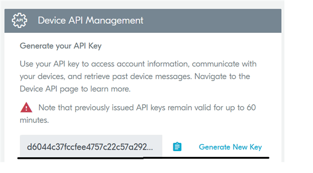

Q1. At prj.conf, nrf cloud location service was enabled. But, I have no idea how to set up credentials (API key).
       At multicell location library document, it didn't built up a link how to configure at my nrf cloud account.
  At my nrf cloud account, I found below. Was it the API key used for location service?
Q2. Below is my log out. I used the API key from my account.  However, HTTP server didn't respond when request was sent. What does error -35 mean?
       At document said, so far, it's only SCELL but not MCELL. So, it was normal at the log that no neighbor cells were found?
