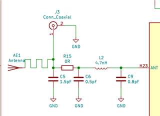

I was using the MESH SDK 5.0.0 Dimming Server Example on nRF52840 DK and Dongle it worked fine so i designed a custom Board according the Designrules of Nordic.
Setting:
PCB is a 4 Layer 1.6mm, both Cristal where mounted (same Types as on the DK Board)
(Backside)
Antenna is an Inverted F Type
Antenna path
Programmig and powerdelivery is made over the nRF52840dk OS: Win10 with nrf Connect Toolchain

  • Hi Simsim,
    Dou you have the J3 connecter mounted ? And can you see any activity there?
    You can use the radio_test example to test if there is any activity on the radio.
    We do Schematic and layout reviews so you can submit the full design and we will give some feedback on the nrf related sections.
    At first glance i don't see anything that would indicate that it would not work. From the pictures you have shared.
    Jonathan

    J3 is mounted but actually i do not have a Scope for the Ghz range.
    I loaded the Radio_test example as you mentioned and did the Test with RSSI sweep  which seems to do what i expect can clearly see the Wave proppagate from CH20 to CH40.
    I also desoldered the R15 Resistor to verify if the Antenna or J3 is the problem. apart of weaker Signal strenge there is no difference.
    I will send you the Schematic and Gerber files private.

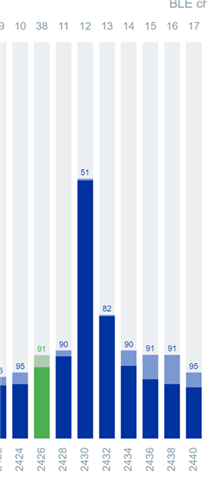

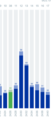

    BLE Blinky on the Customer Board is running(Led, and debugging), but there is no RF activity in RSSI viewer and also not Discoverable by the nrf App(Samsung Galaxy S5,Samsung Galaxy S8Duos , nrf52840 dongle)
    I had set in the radio_test sw the carrier on different channels:
    radio_test CH    RSSI Viewer BLE CH
    0 37 2402Mhz
    20 8
    30 12
    40 17
    50 22
    60 27
     i discovered that the next upper channel also rises when transmitting example Ch12 -64dBm Ch13 -78dBm
    Could there be a problem with the HFCLK 32Mhz Cristal?
    Edit: 20/09/21
    I did some trials with the Dev Board and the Custom board both on channel 30
    Dev Board Custom Board
    Further i Loaded the Zephyr Project "mesh_demo" with the same outcome as with the exampels form the SDK

    When using the radio_test you can set the output power to +8dBm to get a bit more juice out, but yes there might be an issue with the 32MHz crystal. I would suggest that you try to load the crystal with a higher load cap value. From 12pF to 16pF might do the trick.
    You can read about crystal and load caps here: General PCB design guidelines for nRF52 series - Hardware design, test and measurement - nRF5 SDK guides - Nordic DevZone (nordicsemi.com)
    But the you are getting something out of the custom board, witch is good.
