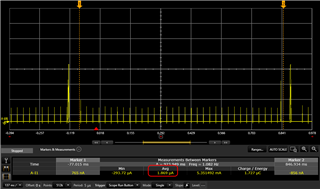

About Sleep Mode(System ON IDLE mode)
Hi ,
We are using nRF52832 IC for our project, Using BLE and PWM peripheral.
We are getting 1.28mA power consumption in the sleep mode.
As per the datasheet it should be 1.9uA.
1. Can you please tell what are all the blocks should be disabled before the device enters sleep mode?
Note : we are already enabled DCDC and LFCLK.
2. I got the info about UART may consume higher current, But we are not using any UART for peripherals. It's ok to not disable it in firmware?
