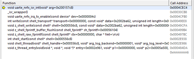

I'm still struggling with porting to 1.6.1.  The previous answer I received enabled me to start compiling.  But when SPM hands off to my application, it hangs there;
Non-secure callable region 0 placed in flash region 3 with size 32.

SPM: NS image at 0x20200
SPM: NS MSP at 0x20033678
SPM: NS reset vector at 0x30cd1
SPM: prepare to jump to Non-Secure image.
It appears to be handing on the Zephyr shell startup trying to use the uart;
Is there some change that requires that I reserve the uart differently than before.  Its uart0.
