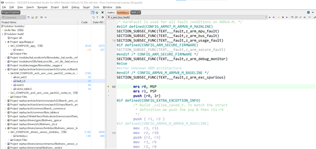

    2. What is wrong with the following code? It is hard to debug as it crashes without any error code. I think the code should be corrected by following the readme.
        // @brief Write internal register of an I2C device.
        // @param dev       Pointer to the device structure for an I2C controller driver configured in master mode.
        // @param dev_addr  Address of the I2C device for writing.
        // @param reg_addr  Address of the internal register being written.
        // @param value     Value to be written to internal register.
        int ret = i2c_reg_write_byte(dev, 0x6a, 0x10, 0x10);
        if (ret < 0){
            printf("cannot i2c_burst_write");
        }else {
            printf("custom i2c_burst_write");
    2021-09-20T03:14:23.225Z DEBUG modem << *** Booting Zephyr OS build v2.6.0-rc1-ncs1  ***
    2021-09-20T03:14:24.666Z DEBUG modem << Testing LSM6DSO sensor in polling mode.
    2021-09-20T03:14:25.584Z DEBUG modem << [00:00:00.320,770] [0m<inf> LSM6DSO: chip id 0x6c[0m
    2021-09-20T03:14:25.609Z DEBUG modem << [00:00:02.690,612] [1;31m<err> os: ***** USAGE FAULT *****[0m
    2021-09-20T03:14:25.641Z DEBUG modem << [00:00:02.690,612] [1;31m<err> os:   Illegal use of the EPSR[0m
    2021-09-20T03:14:25.673Z DEBUG modem << [00:00:02.690,612] [1;31m<err> os: r0/a1:  0x200000d8  r1/a2:  0x200010fc  r2/a3:  0x00000001[0m
    2021-09-20T03:14:25.716Z DEBUG modem << [00:00:02.690,643] [1;31m<err> os: r3/a4:  0x0000006a r12/ip:  0x0000000a r14/lr:  0x00001621[0m
    2021-09-20T03:14:25.758Z DEBUG modem << [00:00:02.690,643] [1;31m<err> os:  xpsr:  0x00000000[0m
    2021-09-20T03:14:25.786Z DEBUG modem << [00:00:02.690,643] [1;31m<err> os: Faulting instruction address (r15/pc): 0x00000000[0m
    2021-09-20T03:14:25.822Z DEBUG modem << [00:00:02.690,643] [1;31m<err> os: >>> ZEPHYR FATAL ERROR 0: CPU exception on CPU 0[0m
    2021-09-20T03:14:25.859Z DEBUG modem << [00:00:02.690,643] [1;31m<err> os: Current thread: 0x20000250 (unknown)[0m
    2021-09-20T03:14:25.890Z DEBUG modem << [00:00:02.997,009] [1;31m<err> fatal_error: Resetting system[0m

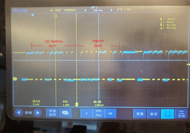

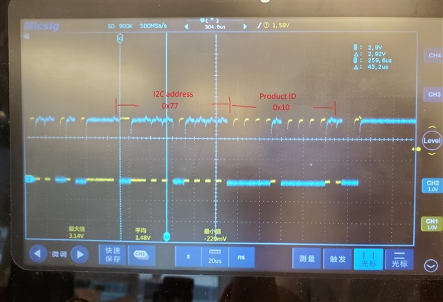

  • Hello, today I have tested other manufacturer sensor (Infineon DPS310) and similar problem appears.
    On one hand, nrf52832 read register correctly.
    	int res = i2c_reg_read_byte(data->i2c_master, config->i2c_addr,
    				 IFX_DPS310_REG_ADDR_PRODUCT_ID, &product_id);
    On the other hand, it does not generate waveform when read and write register.
    	res = i2c_write_read(data->i2c_master, config->i2c_addr,
    			     &REG_ADDR_CALIB_COEFF_0, 1, &raw_coef, 18);
    1. The above are calling the same command i2c_write_read. I think something is wrong with I2C and nordic twim library because it is impossible that both example code from two different manufacturers do not work.
    2. I have found similar problem on devzone: https://devzone.nordicsemi.com/f/nordic-q-a/74704/dps310-zephyr-example-not-working-with-the-nrf9160-sdk
    Is he able to tackle this problem?

  • Hello Markus,
    "Does the sample work with your sensor and DK?"
    No. The sample does not work and I am using ../zephyr/samples/sensor/dps310 example for testing.
    The oscilloscope does not even triggered with command i2c_write_read(data->i2c_master, config->i2c_addr,
                     &REG_ADDR_CALIB_COEFF_0, 1, &raw_coef, 18); and return -EIO
    What does Error I/O means?
