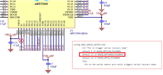

For the usb_cdc_acm_log_recovery.conf, give the CONFIG_PM_PARTITION_SIZE_MCUBOOT=0x10000, and also CONFIG_BOOT_SERIAL_DETECT_PIN=11, using the nrf52840DK (PCA10056)

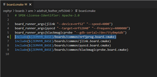

Update!
Change to the nrfjprog flashing replacing the JLink in the cmake configuration file.
It works to west flash.

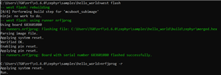

  • Hello Vidar,
    Thanks again for your prompt suggestion.
    It works to flash the program by nrfjprog after following your setting.
    But there is no response after the west flash and nrfjprog -r (reset).

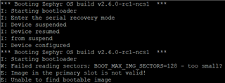

  • Hello Simon,
    Thank you for the info.
    Sry for the delay, as I was busy for other stuff.
    According to your comments, I reviewed the procedure for the nrf52840DK and adafruit feather separately.
    1. For the nrf52840DK, as I saying, everything looks good to configure the MCUBoot and implement the program here.
    Yes, I saw the terminal output as you mentioned in the section 1.
    And there is a little difference for the section 2, as I checked the result below:
    *** Booting Zephyr OS build v2.4.0-ncs1  ***
    [00:00:00.349,731] <inf> mcuboot: Starting bootloader
    [00:00:00.349,761] <inf> mcuboot: Enter the serial recovery mode
    [00:00:00.354,278] <inf> usb_cdc_acm: Device suspended
    [00:00:00.454,498] <inf> usb_cdc_acm: Device resumed
    [00:00:00.454,528] <inf> usb_cdc_acm: from suspend
    [00:00:00.578,796] <inf> usb_cdc_acm: Device configured
    Hello World! nrf52840dk_nrf52840
    However, I think it didn't affect the following processing that I had detected the image list for the new serial port after west flash.
    I did see the required result in the end which means the MCUBoot flashing was working for the nrf52840DK.
    2. For the adafruit feather, same procedure was operated until the west flash. After the west flash, I can't find the new serial port regarding the MCUBoot.
    Meanwhile I didn't see the output same as the picture 1 I posted.
    In addition, I also tried the blinky sample for the adafruit feather, I can see the light is blinking on the adafruit feather board, but no serial port appeared to check the MCUBoot image list.
    Based on my understanding, it actually flashed the program by the nrfjprog or jlink by the west flash while it didn't configure the MCUBoot.
    Can you please provide some suggestions here? Thanks again for your help.
    Best Regards,
    Ethan
