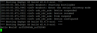

    And there is a little difference for the section 2, as I checked the result below:
    *** Booting Zephyr OS build v2.4.0-ncs1  ***
    [00:00:00.349,731] <inf> mcuboot: Starting bootloader
    [00:00:00.349,761] <inf> mcuboot: Enter the serial recovery mode
    [00:00:00.354,278] <inf> usb_cdc_acm: Device suspended
    [00:00:00.454,498] <inf> usb_cdc_acm: Device resumed
    [00:00:00.454,528] <inf> usb_cdc_acm: from suspend
    [00:00:00.578,796] <inf> usb_cdc_acm: Device configured
    Hello World! nrf52840dk_nrf52840

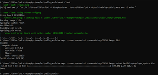

    However, I think it didn't affect the following processing that I had detected the image list for the new serial port after west flash.
    I did see the required result in the end which means the MCUBoot flashing was working for the nrf52840DK.

  • I don't think the issue is related to the MCUBoot, but with the serial logging itself.
    Logging using the Adafruit Feather nRF5284 is configured to use UART0 by default
    https://github.com/nrfconnect/sdk-zephyr/blob/v2.6.99-ncs1/boards/arm/adafruit_feather_nrf52840/adafruit_feather_nrf52840.dts#L16
    UART0 uses the pins 25 and 24
    https://github.com/nrfconnect/sdk-zephyr/blob/v2.6.99-ncs1/boards/arm/adafruit_feather_nrf52840/adafruit_feather_nrf52840.dts#L74-L75
    The nRF52840 DK connects UART0 to the Interface MCU, which exposes it as a Virtual COM port, which enables you to see the serial log. This is not the case for the Adafruit board.
